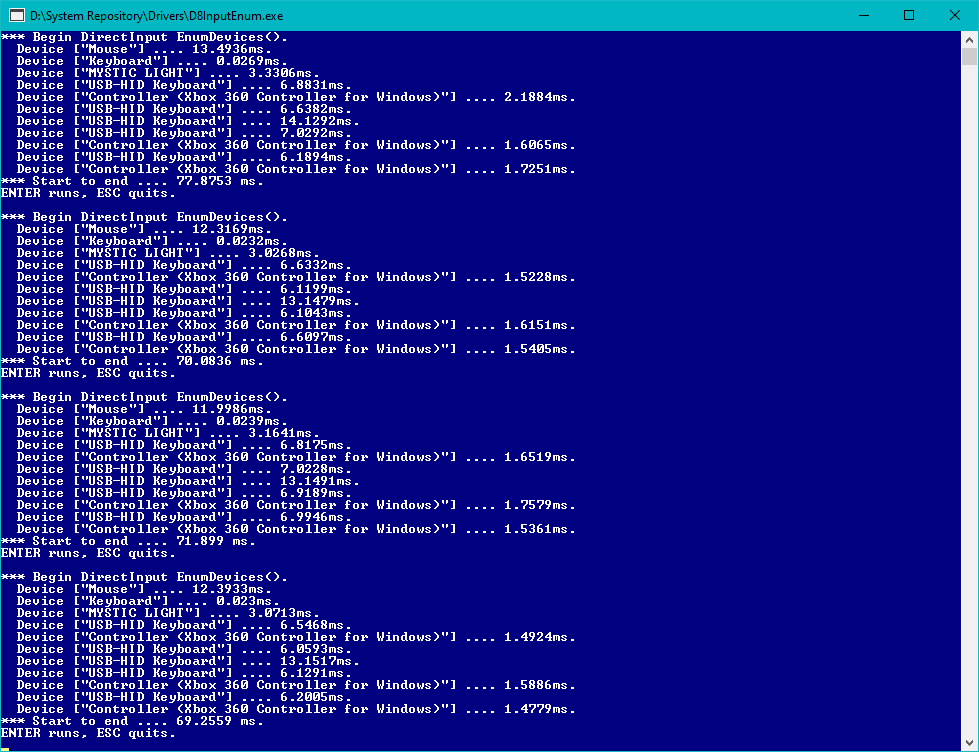

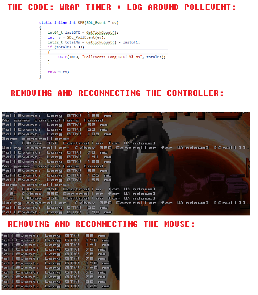

For the first time in 2023 I have answers. I probably shouldn't have waited this long to test this but now that I have, I have answers at last. Context: this game continuously calls SDL_PollEvent() as part of the main loop. See the following picture:
And there's more: I believe it does indeed all come down to DirectInput. Setting SDL_SetHint(SDL_HINT_DIRECTINPUT_ENABLED, "0"); should fix it. If this were a checkbox in the settings, people like myself could uncheck it.
As you can see from the picture, removing/plugging an input device(controller, mouse, etc.) causes SDL_PollEvent() to be very slow. Those hitches I mentioned happening several times in order after a single plug event were matching the stuttering EXACTLY in the game title, so what you see in that console log are 2-3 slow polling events per single device connect/dc. The polling should be async from whatever depends on its output. My guess, a thread that loops polling and places the latest obtained result in a mutex-wrapped result that the outer call just enters to fetch. The wait time just about matches the time it takes to do a full DirectInput8 EnumDevices(), and this is only speculation on my part but I rather confidently believe the blocking event is waiting for an enum under the hood. Design strategy seems to be: don't assume SDL_PollEvent() is always going to be instant. Sometimes, it can be very slow. Your thoughts? |
