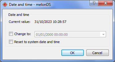

The RTC rework is done Oct 31st 2023, by Arisotura |
Basically: melonDS has got a fun little dialog for changing the date and time now. Basically what it does is show you the current date and time of the emulated DS. You can change it to any date and time, or you can reset it back to your computer's date and time. What you set is saved as an offset in seconds from your computer's time. Every time you launch a game, the computer's time is used as a reference to calculate the emulated DS's time, and then melonDS does its own time counting from this point. This also means that, unlike the previous behavior, if melonDS runs too slow or too fast, it will affect the passage of time for the emulated game from your perspective. The point is to keep melonDS's time counting accurate from the perspective of the game. This was also the occasion to rework the RTC emulation itself, because it was quite lacking. For example, when returning the current time, it would simply return the current hour from 0 to 23, ignoring the AM/PM flag that is also encoded in the hour register. It gets a bit weird, because the way this register works depends on the 12/24-hour setting in status register 1. In 24-hour mode, the register goes from 0 to 23, and the AM/PM flag is automatically based on that. In 12-hour mode, the register goes from 0 to 11, and the AM/PM flag needs to be set properly for things to function. I was also able to add support for writing to the date/time registers. This means that for example, you can boot the DS firmware and change the time from there, and melonDS's date and time setting will reflect that. Perhaps not very useful, but a nice touch regardless. ... read more |
